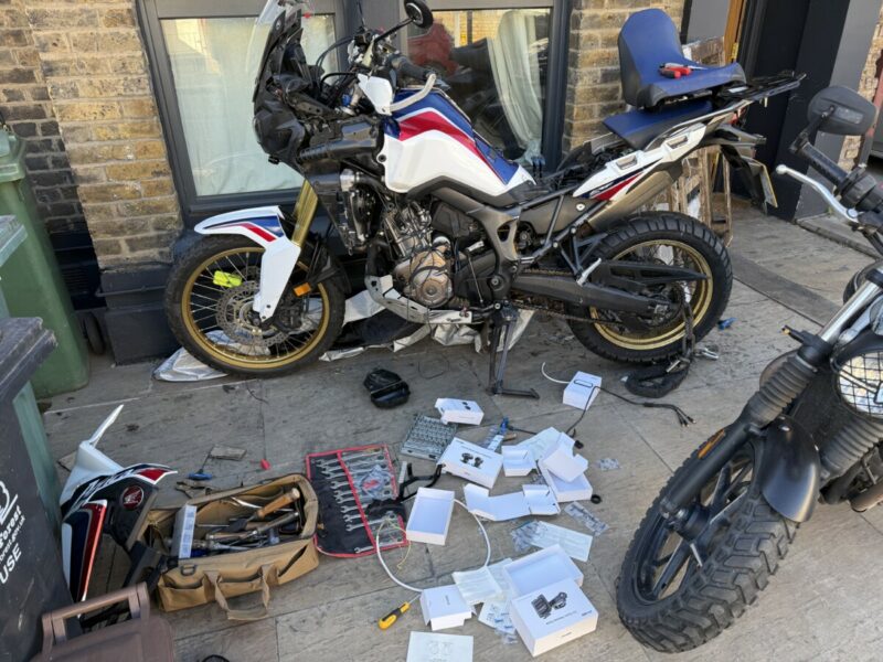

Installing the Chigee AIO-6 on a Honda Africa Twin: What to Expect
Installing the Chigee itself, mounting it to the bars and connecting it to the battery, was straightforward. The part that took time for me was finding the ACC fuse: the wire that tells the Chigee the ignition is on, so it powers up and shuts down with the bike rather than running continuously.
The moment I realised I should have googled first.
On the Africa Twin, the internet will tell you it’s buried behind the front instrument cluster. On mine, this meant pulling off fairings and digging around in the dark with a torch, staring at a web of wiring I hadn’t seen since I bought the bike. After more digging than I’d care to admit, I discovered there was a simpler option: the fuse box under the seat. It turned out I didn’t need to pull apart my bike to find an ACC slot, I could just splice it into an existing fuse there that was already ignition-switched. I felt like such a man writing that sentence, and doing the wiring. The Chigee wire was slightly too short to reach it cleanly, so I extended it. A simple job, but one that added an hour to the afternoon.
When it finally lit up for the first time, sitting there in my hand with the bike behind it, there was a proper little moment. It worked first time. No drama. After a couple hours of swearing and wishing I’d googled before starting, I came out of it feeling like I knew my bike better than I did going in. The Chigee did as good a job as possible of making the install simple. My bike, specifically its 2016 fuse layout, was the limiting factor, not the unit.

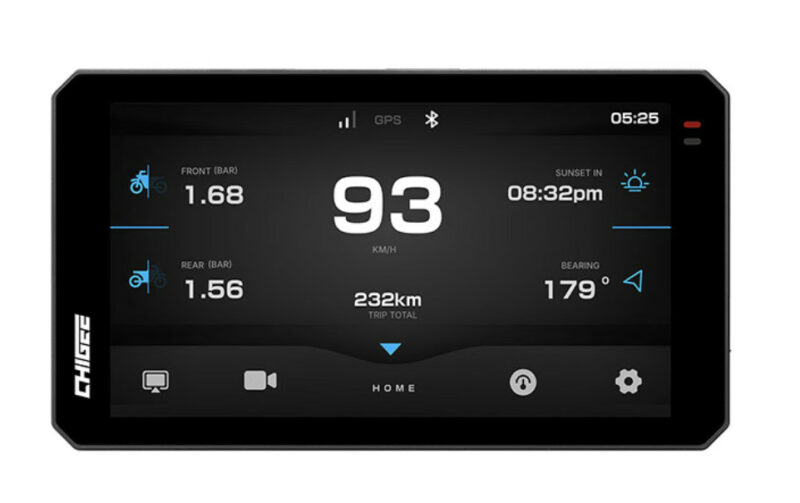

The Chigee home screen gave a load of really interesting information. This clean layout is where you see your speed, tyre sensors, bearing and even when sunset is. You can also see your lean angle and altitude a tap away. We have a lot of this in Scenic in our ride tracking screens, but having it a single button away made me even more interested to actually check it mid-ride.
The thoughtful design of the Chigee unit caught up with me bit by bit as I tested. My favourite feature was a simple one: the four buttons on the top. These take you instantly to the home screen, Carplay/Android Auto screens, and Cameras (also allowing you to switch between front and back views). The instant responsiveness of these taps made such a difference when switching between apps, and checking behind you, that I actually started using the rear camera over looking over my shoulder when caught in heavy traffic.

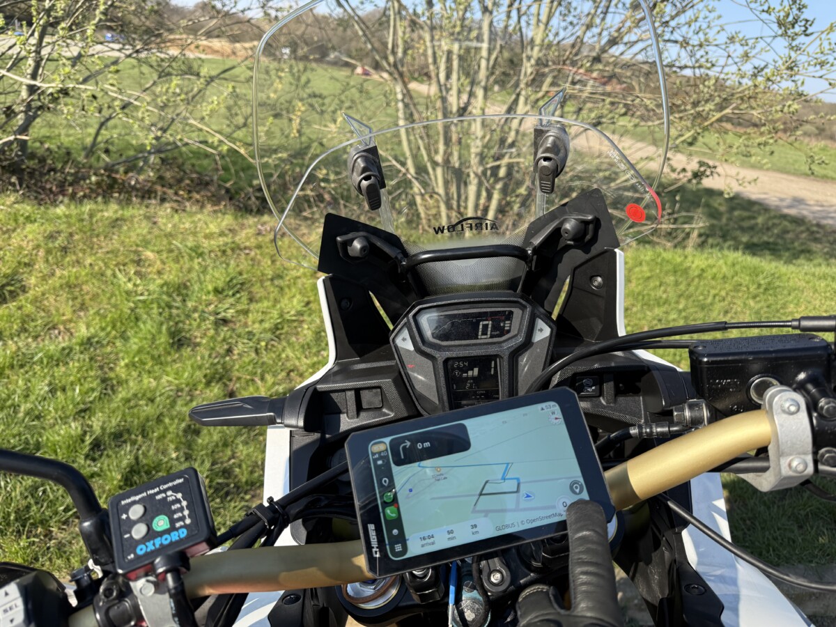

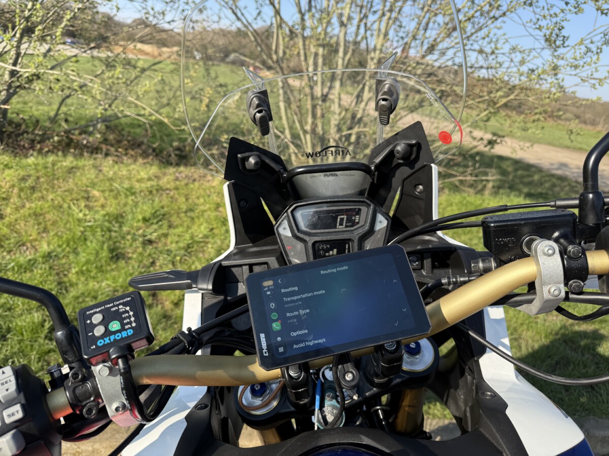

Full disclosure: This was actually the first time I’d used Scenic through CarPlay despite having used it on my phone for years. The experience was noticeably different, in a good way.
The Scenic interface on the Chigee AIO-6 strips back to exactly what you need: clean navigation, a clear map, and touch controls sized for gloves. The routing options are all there, motorcycle mode, curvy routes, avoid motorways, all accessible in a couple of taps. The layout feels almost more considered than the phone version (don’t tell Guido I said this, or do actually, he listens to feedback). There’s something about having it on a dedicated screen in a fixed position that makes it feel properly part of the bike rather than something bolted on afterwards.
The one limitation is that you can’t browse routes or use the Power Planner within CarPlay itself. The workaround is seamless though: switch to the Scenic app on your phone, set the route, switch back to the Chigee. Your route is there, ready to go. It took about twelve seconds the first time I did it.
