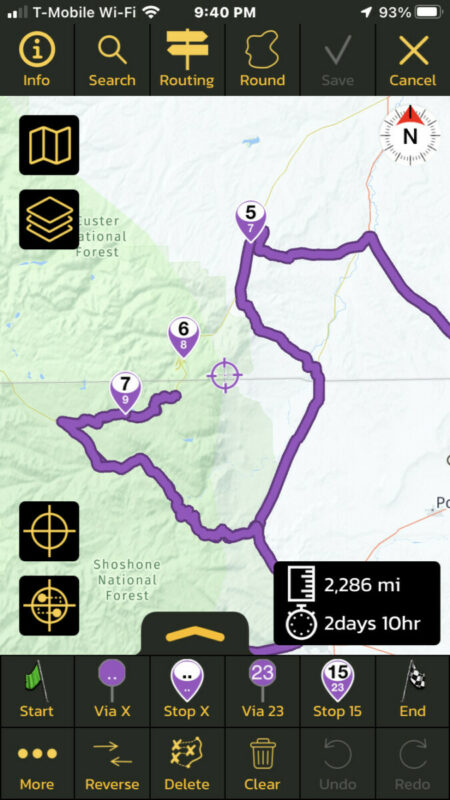

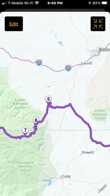

Quote from Lbnyc on 04.08.2022, 20:59I am working on a route passing by Beartooth pass and this is whats happened.
- pict 1 show the route passing by some stops as I decided. This was looking like that until you updated the maps a few hours ago.
- pict 2 show that I cannot reach point 6 and give me a 200 miles? Detour. The previous road show but is nit continuous
I know that the pass is sometimes closed and I would have to do the detour but at this specific time it is open, so I was wondering how the map update because in these parts open or close can happen at any time and change from one day to the next.
if I understand the utility I found it is difficult to create a route that I will take in 6 months.

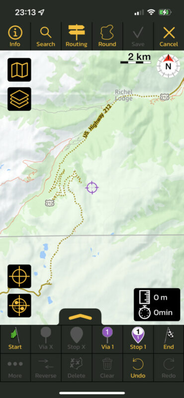

Quote from Guido on 04.08.2022, 23:27It looks like the properties of this stretch around Richel Lodge (see screenshot) prevent routing over it. It also looks different on the map (like a dotted line in stead of normal solid). Even HERE's own app (HERE WeGo) is not routing over this stretch at the moment.
I've looked at HERE mapcreator (gives more info on road properties), but there's nothing I see that would cause this. I've filed a HERE support request to find out what's going on. Sorry I can't be of any more help at this time. I'll report back when I know more.
For the moment, there's not much that can be done. There are a few workarounds: https://scenic.app/help/wont-take-a-stretch-of-road/
Quote from Guido on 05.08.2022, 06:33Response from HERE. I don’t know if this construction closed message is true. Do you?
“the stretch of road you reported received a "construction closed" attribute due to real world road conditions. The closure of this road will last until 2023/2/1. During that time a routing will not be possible. According to my knowledge this attribute is not reflected in the HERE MapCreator”
