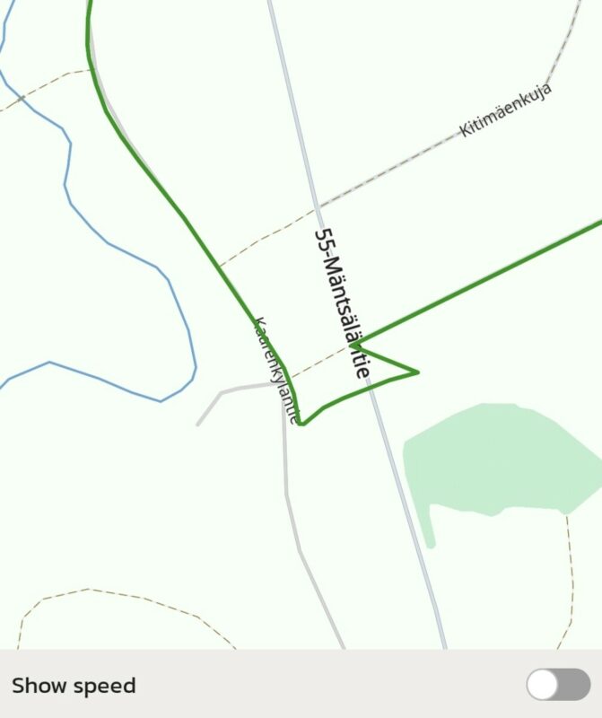

I don’t know if this is due to the mobile phone’s weak GPS signal, but the recorded driving trace often appeared tens of meters off the road, and at intersections it continued straight ahead even when you were actually turning. The line often returned to the correct position only after tens of seconds — sometimes even after a full minute — despite having a clear view of the sky.
GPS receivers inherently have inaccuracies. Most modern phones however should have a GPS accuracy of about 5 to 10 meter in 'clear sky' conditions. This is probably related to the compass issues mentioned above (GPS receiver also reports heading). It sounds like your GPS is having difficulty getting a clear signal. What phone are you using, and how is it mounted to your bike? The rainy conditions could influence this somewhat, but not to the extent you are describing I believe. Having said that, it could also be a performance issue.
Similarly, I believe that in some situations the issue is caused by poor GPS reception and partly by the phone itself. In particular, this is completely normal for GPS devices on stretches where taller forest or high buildings are close to both sides of the road for an extended period. However, this wasn’t always the case — the issue also occurred while driving through 'clear sky' areas. On the same trip, I occasionally used Google Maps for navigation in similar situations with the same phone. Based on my observations, the location marker seemed to follow the road more accurately. My phone is a Samsung A55 5G 256GB. It is mounted on top of the BMW R1200 GS motorcycle’s navigation bracket, slightly under the windscreen. I’m including an example (pic) where I was riding from the north, turned onto the road marked with a dashed line, and continued east. In this case, the wandering of the track was under 100 meters, and it corrected itself when I stopped to yield to crossing traffic. The sky view at that location can be seen from the following link: https://maps.app.goo.gl/oyHEUZzMckdVA1GP6 I want to emphasize, that the route was drawn on the map perfectly well and accurately enough, so this is not a major issue.

1) For these extra U‑loops, a simple solution would be the ability to select two route points and click “scissors,” which would remove all route points between them and connect those two points directly. If possible, Scenic could also automatically suggest such spots on the route where two route points appear close together within a short distance in both directions, and ideally allow removing the U‑loop with a single click. The connection would naturally occur at an appropriate intersection.
2) Correcting a route line that wanders away from the road (GPS error) could often be done in the same way: selecting two route points and deleting the points in between. However, if the road is winding or curving, it would be better if Scenic itself could recognize the road and move the route roughly onto it by creating new route points or adjusting existing ones and removing unnecessary ones.
3) It would also be a very useful feature if single route or several points could be simultaneously moved, deleted or added.
Another extremely useful feature would be the ability to merge two or more separate route recordings. In other words, the endpoint of Route A would connect to the starting point of Route B, forming a new route whose starting point is the original start of Route A and whose endpoint is the original end of Route B. I ended up with several routes on the same day that continued from the previous route’s endpoint, partly because I was cautious about not losing a multi‑hour continuous recording or other reasons. This could be implemented under My Rides > actions > Merge Rides, after which you could select two or more routes to merge, resulting in a new combined route saved to the list.

Quote from Guido on 29.07.2026, 10:51OK. Thanks for the additional information. Scenic doesn't snap the raw GPS location to roads on the map at this moment in time. That is one reason why you might see "drift". This doesn't explain the compass issue though, so there is something wrong there. We'll investigate this.
Thanks for your suggestion on the recorded ride editing. We'll take those into account when we start working on that (which may be a while as there are many more things on the list still, especially for Android).
