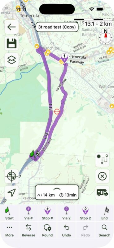

Quote from TGC on 18.02.2026, 22:08I see the RV/Camper routing option in scenic but have not been able to find any documentation. Can anyone point me to documentation on what features are included for RV navigation? I experimented recently with it but it navigated me onto a 3 ton limit road even though I’d entered 10000lbs (5 ton) as my RV weight. Thus I’m wondering if the length, width, height and weight are perhaps not yet used by the routing algorithm or perhaps the map data didn’t have the weight restriction for that road. Any info appreciated as I’m a long time motorcycle user of Scenic now including RV travel.

Quote from Guido on 18.02.2026, 22:24Weight and dimension are taken into account. So I’m guessing map data is not up to date. Can you tell me which road this was? Then I can check if those limitations are known in the map data.

Quote from TGC on 18.02.2026, 22:57Good to know.
Here’s a test route through the offending street.
https://scenicapp.space/viewRoute.php?rid=TqGwkvjmThe location facing the sign just before it becomes 3t is 46654 Rainbow Canyon Rd, Temecula, CA 92592 USA (Lat/Long 33.4530574, -117.1296718). The other sign is at the corner of Pechanga Parkway and Rainbow Canyon Road.
Here’s a google street view URL of the 3 ton sign. Looking back through street view history, the sign was added sometime between 2007 and 2011.

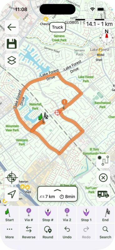

Quote from TGC on 18.02.2026, 23:11Out of curiosity I just tried planning another route between points either side of a 7’7” tunnel near me to try height and am routed through the tunnel even though I set 10’ height for my RV.
Here’s the test route for info.

Quote from Guido on 19.02.2026, 11:29This is a bug. Have fixed locally and will make sure the fix is in upcoming update:
For Rainbow Canyon Rd there is also a map data issue. The weight restriction was not registered in the map data. So, although, with the fix, the route is a bit different, it still takes you over that road at the moment.
Tunnel on OSM: https://www.openstreetmap.org/way/402505817
- Height restriction knownRainbow Canyon Rd on OSM: https://www.openstreetmap.org/way/131974128
- I just added the maxweight tag, but will take a while (upto 2 months) for it to be reflected in ScenicFor the future, if you run into these restrictions not being know, you can report it to OSM, or even fix it yourself: https://scenic.app/help/reporting-map-errors/
