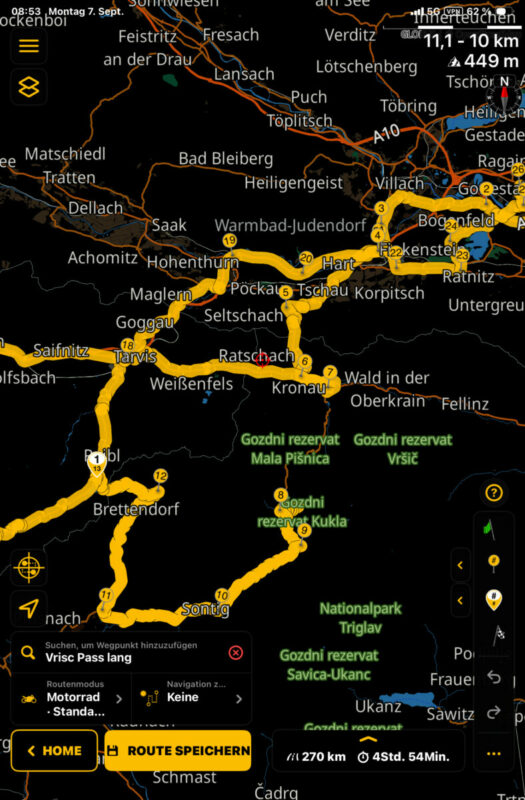

Quote from Karlchen on 07.09.2026, 00:59Hallo Guido,
Ich verstehe nicht, warum Scenic nicht zwischen Punkt 7 und 8 fahren will.
Ich habe verschiedene Einstellungen versucht. Kurviger und Google Maps fahren durch.
Was mache ich falsch?Beste Grüße
Karlchen

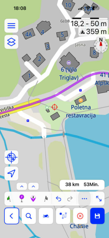

Quote from Guido on 07.09.2026, 09:23For me it calculates taking that road.
I also see only recent map updates that might have changed this behaviour, but just to be sure... are your offline maps up to date?

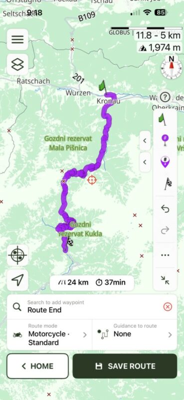

Quote from Karlchen on 08.09.2026, 01:05Hallo Guido,
d
ja die sind auf den neuesten Stand.
und Maut erlaube ich.
es ist gleich mit 4.44 auf dem iPhone und iPad
Hallo Guido,
d

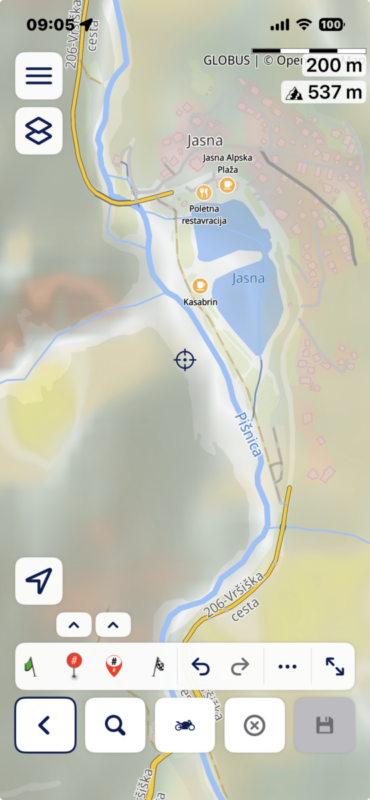

Quote from pe112 on 08.09.2026, 01:16Hi Karlchen,
it seems to be something with the latest GLOBUS map versions.
At Jasna a piece of the 206 is missing, making routing impossible in every mode larger than "bicycle".
In the original OSM (https://www.openstreetmap.org) this stretch of road is present:
Best, Martin
Hi Karlchen,
Best, Martin

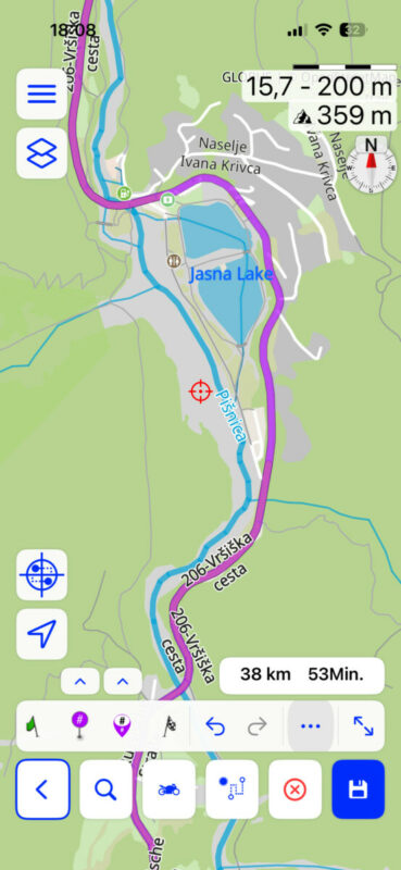

Quote from mattsz on 08.09.2026, 04:56Quote from pe112 on 08.09.2026, 01:16Hi Karlchen,
At Jasna a piece of the 206 is missing, making routing impossible in every mode larger than "bicycle".Yet Guido has no trouble routing there using "motorcycle-standard" mode... I wonder why? 🤷♂️
Quote from Middelfrangge on 08.09.2026, 10:16Hi,
I also have no issue with the routing although the road around the lake is missing. It seems to be a visualization topic only with the map.
regards
Thomas
regards
Thomas
