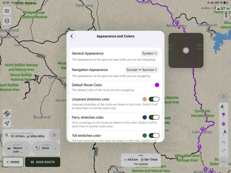

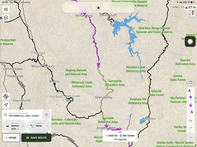

i have this ride where day 1 we go down and day 2 we come back (reverse route).
Day 1 is paved (which it is) and Day 2 is unpaved? I have toggled settings and map styles.
edit: if I add a stop (3) along the unpaved section it turns to paved but not always

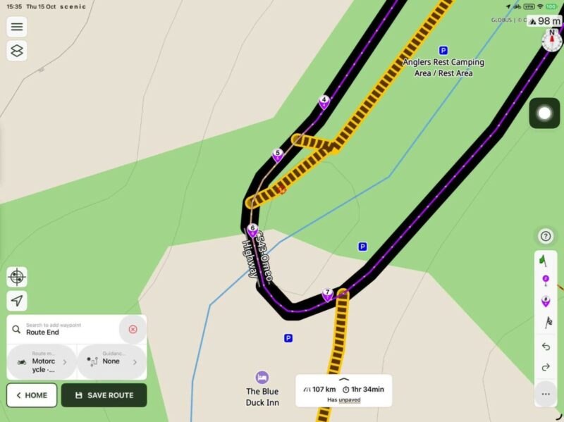

Quote from Guido on 14.10.2026, 19:21Yes. I see, and I know why this is happening. It’s the result of a compromise I had to make, sacrificing precision for performance.
To give unpaved, toll and ferry stretches a different color, Scenic splits up the route in ‘maneuvers’ and gives each maneuver the appropriate color.
A ‘maneuver’ is the piece of route between one navigation instruction and the next. If a maneuever has an unpaved stretch Scenic knows this, but it’s a Boolean value. hasUnpaved true or false. We don’t know if it’s entirely unpaved, partially, let alone which part. So, for the moment, if hasUnpaved = true the whole maneuver is drawn yellow.
The way going and way back might have different maneuvers / different maneuver instructions.
A stop also generates a maneuver instruction.

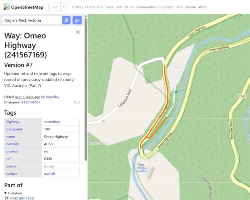

Quote from Old Man Emu on 14.10.2026, 22:43Thanks the explanation. I've added waypoints along the section to isolate where the offending map data might be as I know that the whole section is paved.
It seems to drill down to this location and my guess is that the service road down to the river which is gravel intersects on the main road by "too far" and is crossed therefore creating an IsUpaved boolean? I've tried to replicate this elsewhere but I cannot get a consistent feel for it?
Perhaps if a section between A and B is unpaved insert Vias?
