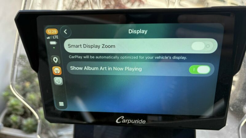

Quote from teflon08 on 06.04.2026, 12:24Hello Guido,
I can‘t find in CarPlay „smart display zoom“.
Normally you have no CarPlay on iPhone. On the Carpuride screen, you can‘t change it.
Otherwise, is it the solution? I think you can zoom the whole screen, but not only the buttons.
Is it so, I will stay at scenic app on iPhone.But it’s possible that I missunderstood this.
Greetings
Frank
Hello Guido,
Greetings
Frank
Quote from Guido on 06.04.2026, 12:33It's in Settings on your CarPlay unit, then choose Display. (notice the Settings icon on the left... that's the "app" you should choose in CarPlay).
If this setting is not showing, make sure your iPhone is up to date with iOS version (26.4). If it's still not showing, contact Carpuride support for a firmware upgrade.This will zoom the entire screen. There is no way to make only the buttons bigger.
