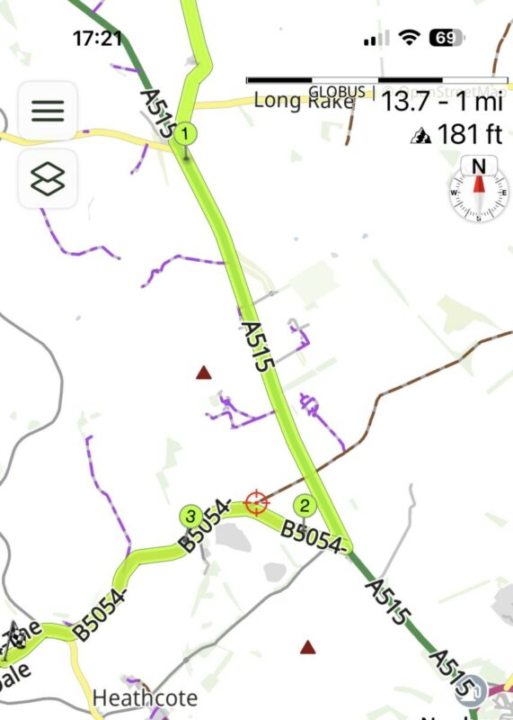

Scenic adds wrong waypoint requiring U Turn
Quote from HighPeakRider on 10.08.2026, 09:46Scenic added this little leg for no reason?
[caption id="attachment_10865" align="alignnone" width="369"]
53.167575,-1.778387[/caption]

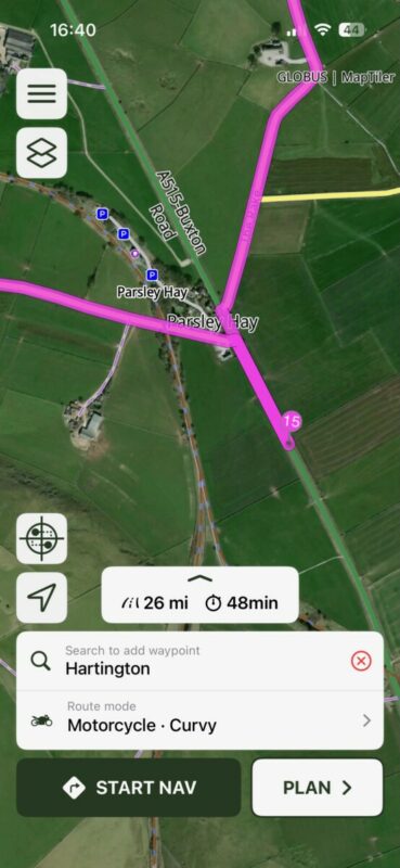

Quote from HighPeakRider on 10.08.2026, 10:08[caption id="attachment_10866" align="alignnone" width="369"]

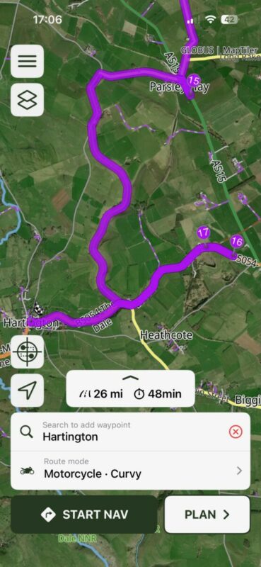

Quote from Dae on 10.08.2026, 10:23Do you have offline maps downloaded, and if so are they up to date?
I have the latest maps, and it routes fine for me
[caption id="attachment_10867" align="alignnone" width="571"]
Quote from Middelfrangge on 10.08.2026, 12:39Hi,
it did not add a leg, but it did not finf a proper routing from point 15 to 16, thats why you have to legs. Just simply move point 15 or/and 16 closer to each other and maybe than it will work. Whichever routing option I tested, just camper used your routing if I have no vias added.
Thomas
Thomas
Quote from HighPeakRider on 10.08.2026, 13:44All my offline maps are upto date.
The issue is caused by the ‘avoid highways’ switch being on.
Not exactly sure what Scenic classes as highways in the uk but these were just country lanes.

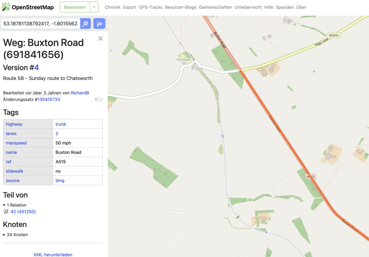

Quote from MartinW on 11.08.2026, 02:22Quote from HighPeakRider on 10.08.2026, 13:44Not exactly sure what Scenic classes as highways in the uk but these were just country lanes.
The A515 Buxton Road is classified as highway=trunk, and this road type is usually treated similarly to motorways for route calculation.
https://wiki.openstreetmap.org/wiki/Tag:highway%3Dtrunk
