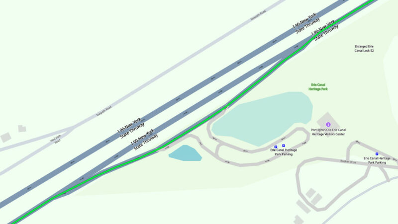

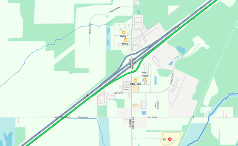

On a major interstate or divided highway in the US, Scenic is routing me to take an exit, only to return back to the interstate.  There are no vias or any other reason for the routing.  I did an IBA ride last Saturday and missed a via point which nearly caused me to not have enough miles in the ride.  I think it was because I was ignoring these random exits and once Scenic determined I was off route it recalculated.  I turned off the feature once I realized what was happening.
I only recently started seeing this behavior and the places the routing is trying to take me off the main road make no sense.

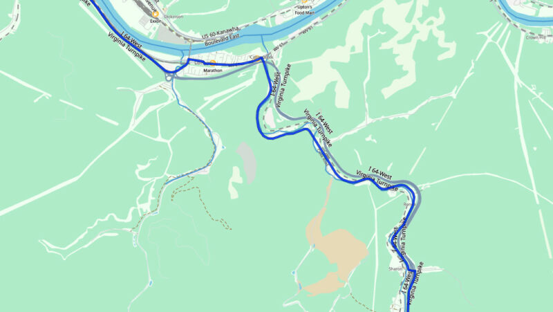

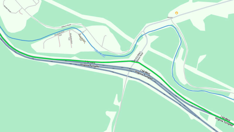

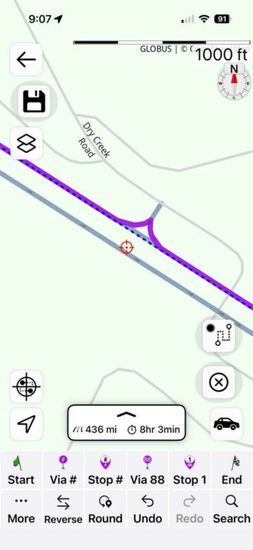

The first image below is from a route, the others are from the recorded ride where scenic directed me to exit during the IBA ride.  I did not but I guess I was close enough where it recorded my location as being on the exit and on-ramp.  This is happening on multiple roads in different states.

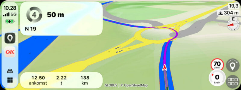

Hi. I have got the same problem. It happen in germany, in Poland, in Denmark and in France.

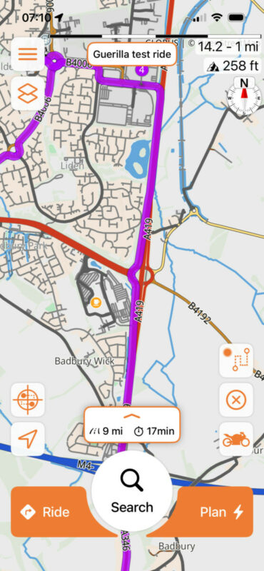

I was routed off and back on to a major route yesterday.  I’ve seen this behaviour before in earlier versions of Scenic but not recently but then I very rarely ride any distance on major roads to encounter it.  Currently I’m using beta 4.42(2)

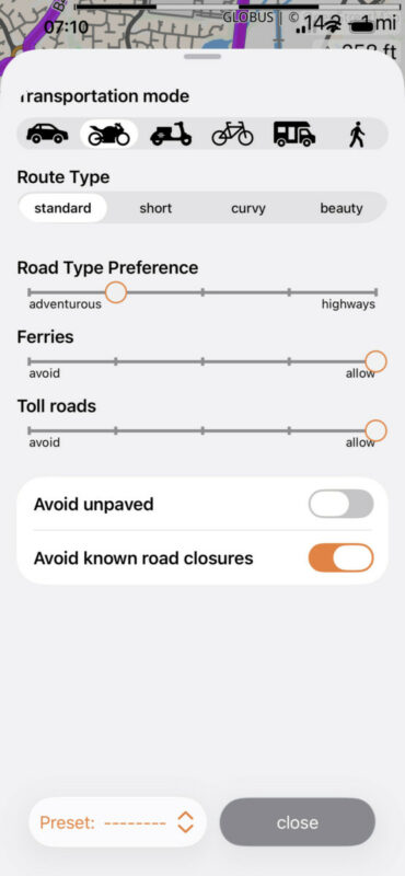

Route share (short test ride route to try out a potential bike purchase), put together with standard motorcycle routing as shown below.  This is my standard routing settings but I don’t typically allow Scenic to determine my routes rather I place vias to shape the route myself.  If I change to one click less adventurous the highway deviation is gone.

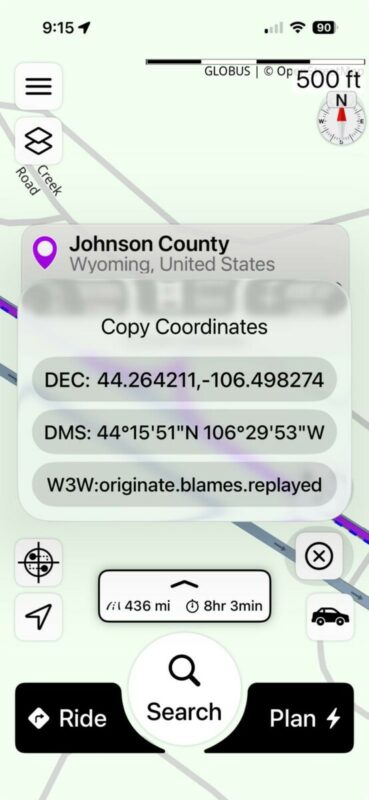

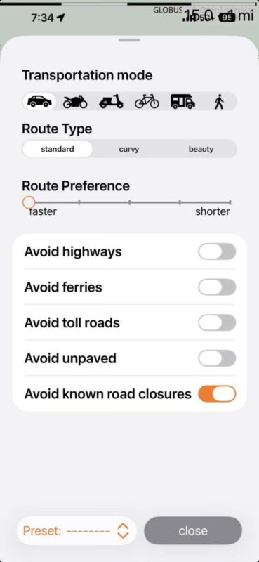

@hook, having trouble reproducing this specific one. I could reproduce the other ones. Could you send me the link to this route? Select route from route list > 3 dots button top right > share link. If you don't have this route saved, a screenshot of your routing settings if possible?
Sure.  Happens multiple times between Gillette, WY and Buffalo, WY on this route - while skipping some of the exits like it should.
https://scenicapp.space/route/msWxxFiy
Hope that helps.  I'm not sure what settings you'd want to see.  This route was created in Google Maps and dropped into the online import converter.  Imported onto my iPhone as a Track.

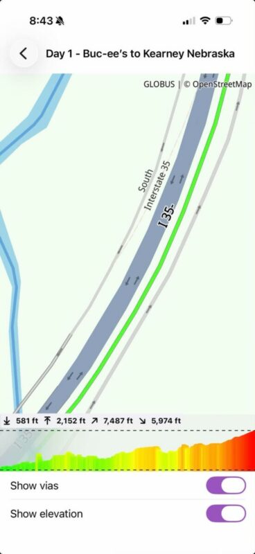

I have a Scenic question. I made several routes for a 12 day trip on Scenic using my iPad. The first days route from Dallas to Kearny, NE was a straight shot and I just used a start and an end and Scenic made the route. There were no pins. During the drive Scenic kept telling us to get off at an exit and get right back on. Obviously we didn’t follow it, but it did it maybe 20 times during the route. (Very annoying) Any idea why it would do that? Other routes where I used pins Scenic didn’t do that.
I have attached a picture from the route and it looks like scenic has the route off to the right of the actual road, which certainly may be the issue. But I’m not sure why Scenic did that.
Hi @dougb,
This was addressed (or at least so I thought) a few versions ago. Not only for Android but also for iOS. Could you check if you have the latest version (v4.44 for iOS). You can see version number at the bottom of Settings. If you don't have the latest version, update through the App Store: https://apps.apple.com/app/id1089668246
If you do have the latest version, could you share start and destination of that stretch with me so I can investigate further?
