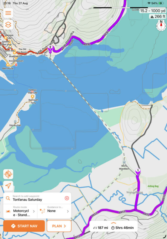

Barmouth Bridge, Wales, UK is not routing.  Coordinates 52.714284,-4.038319
Motorcycles are permitted and this seems to be correctly attributed in Open Street Map.  It is a toll road which are allowed in my route mode.  Scenic 4.44(1) but I doubt this is a beta issue.
[caption id="attachment_11054" align="alignnone" width="627"] Screenshot[/caption]

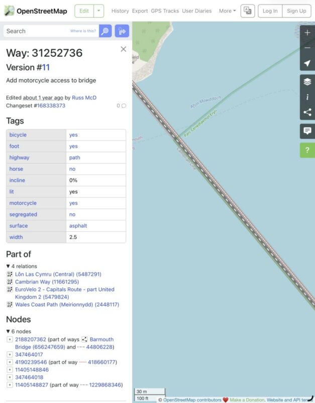

Motorcycle routing excludes highway=path.
https://wiki.openstreetmap.org/wiki/Tag:highway%3Dpath
Quote from Guido on 27.08.2026, 13:59
Okay, then the data is wrong.  Boots on the ground, motorcycles are permitted.
