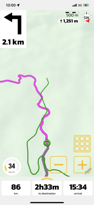

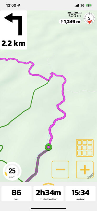

Quote from johnnysneds on 25.11.2021, 08:02I keep getting these random green route lines appearing on my map. They will flash across the screen and do weird things. What is it?
Secondly, there seems to be more route voice instructions than the previous iteration of Scenic, even when I am on the main route/ road with no proper runs. It appears to give instructions to make a turn when there is a sharp bend etc.
Quote from Guido on 25.11.2021, 08:19Hi John,
The green line is a bug. It’s supposed to be the trail of where you’ve been, but it’s drawn at a higher elevation, so you get a distorted view in 3D mode. An update is currently being tested which fixes this. I’m hoping to release the update on the next few days
Until that time you can turn off the trail if you like. Settings > Navigation & Tracking > Show Trail.
The ‘more’ instructions is a strange one. The new mapping framework should actually give less instructions in these cases. It happens when, at a junction, the map doesn’t know the road priorities, assumes that you are arriving at an equal junction, while in reality you are on the ‘normal flow’ road. I’m afraid this is out of my control though as it’s a map data thing. You could report this map error if you like. In Settings at the bottom there is a way to directly report map errors to the map provider.

Quote from johnnysneds on 25.11.2021, 08:29Thanks for the feedback Guido. Turn left/right every 30 seconds during Dark Side of the Moon is more of an annoyance than anything else.

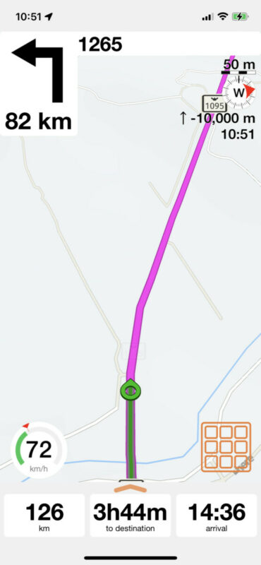

Quote from Guido on 25.11.2021, 11:25Just did a simulation (I changed via point 2 to the start and via point 4 to the destination). I only get 1 direction. When I arrive at via point 1 (in your case via point 3), 83km further:
I'm not sure what happened in your case. Perhaps the route keeps recalculating because of inaccuracies in the GPS signal? (I imagine this route goes through the mountains)? In the mountains GPS signals can be inaccurate indeed.
The current version gives you a voice message when upon a recalculation. In the upcoming update this will be removed. You'll only here a recalculation sound (which you optionally can turn off as well in settings > sound & haptics ). I think / suspect that will resolve this so you can listen to Pink Floyd mostly uninterrupted. 🙂
