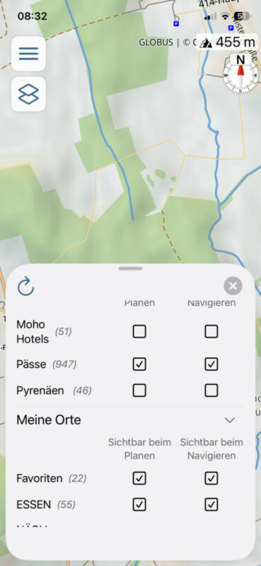

Quote from Drexx33 on 27.09.2026, 10:51Howdy everyone. Is there a way to have POI groups for things like just gas stations, just hotels, etc., and turn them on and off as needed during routing?
The only place I’ve found to turn POI’s on and off is when editing a map style. I would like to have a set of POIs for again, an example, gas stations, and hotels, but turn them on & off as needed while routing, rather than have them on all the time. Is that possible?

Quote from johansw on 27.09.2026, 11:40When on a route, you press the big menu button down at the right and here you choose the gas station symbol which gives you the stations around your position.

Quote from Mex on 28.09.2026, 00:32Hi Drexx33,
go to layers. Top left second button.
Select: my POIs or places and check or uncheck as you like. See them while planing or navigating.
