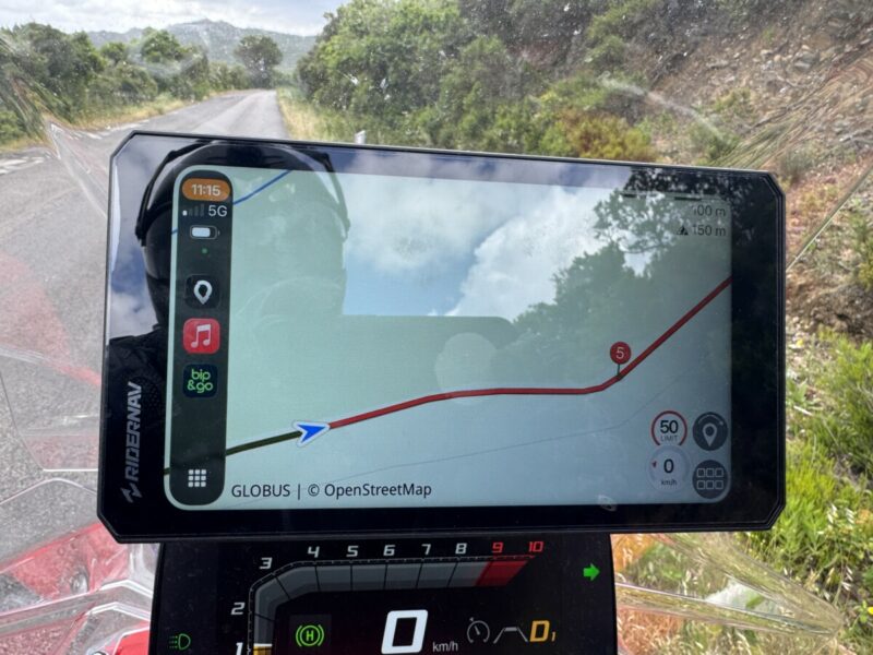

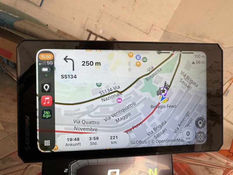

Quote from Nazguel on 15.05.2026, 00:13Hello Guido,
now I had the problem again.
I started a route, a problem occures. I stopped and switched eth off. Deleted some waypoints and the start of the route. Set the startpoint to the point I´m now.
Start the route with carplay and no additional information are on the screen.
Ok, no problem for me in the moment!
Next brake, shut off eth.
New start after coffee, eth is there!!! No other changes!
What do you think helps more coffee or shut down? 😉
If you need further information, let me know!
This picture was made later. All the information stays there for the complete trip!
Greetings, Holger
