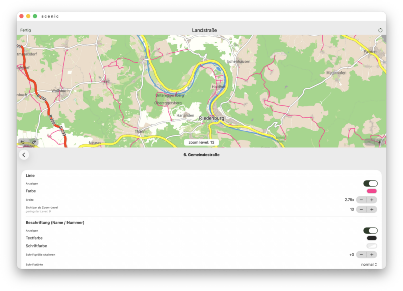

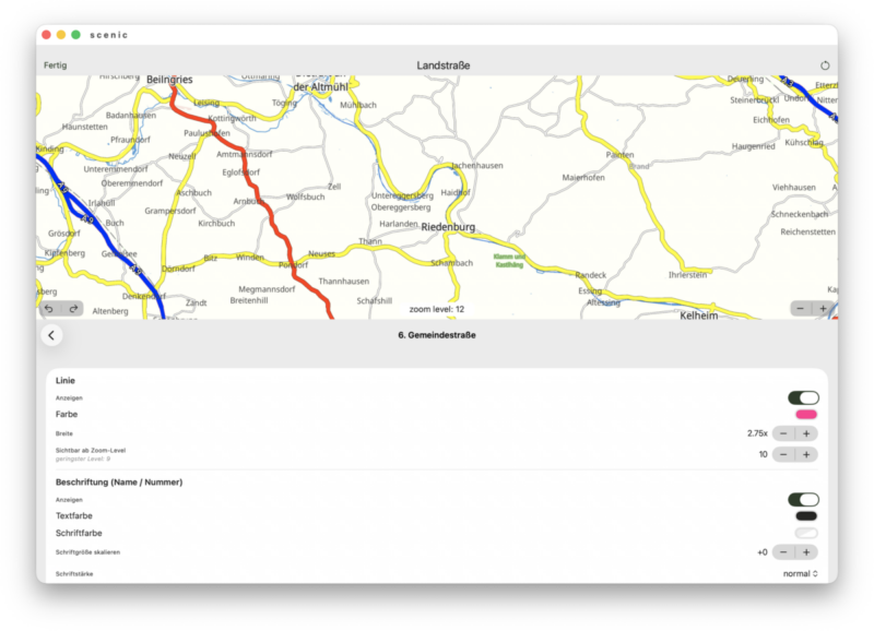

I think there is an issue with how small roads are displayed at different zoom levels. I colored them red to make them more visible. They are visible at zoom level 13, but not at zoom level 12. However, according to the settings, they should be visible from zoom level 10 onwards.
This is a bug. The “lowest possible” zoom level for these roads is 13, not 9 like displayed now. So, you shouldn’t be able to select below 13. I will correct for the next update.
