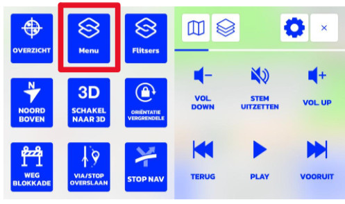

As a solution I use the free commands in Scenic's navigation menu. With this I call scripts that you can create in IOS. I'll end the scripts with a return to Scenic.
Operation can be hands-free or with one touch.

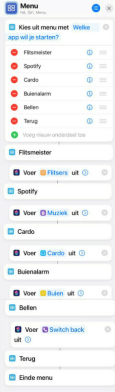

It is also possible to start a phone call and return to the navigation screen before the screen is locked. It gives Siri time to initiate a call.

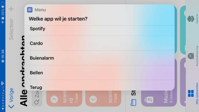

In the meantime I'm one step further. You can also add a menu in the same way. You can call up this menu via the navigation menu. From here you can, for example, start the apps Cardo, Flitsmeister and Spotify or return without action.
This solution is not perfect, but it works. I would like to share these experiences and am curious about additions or suggestions from other users.
