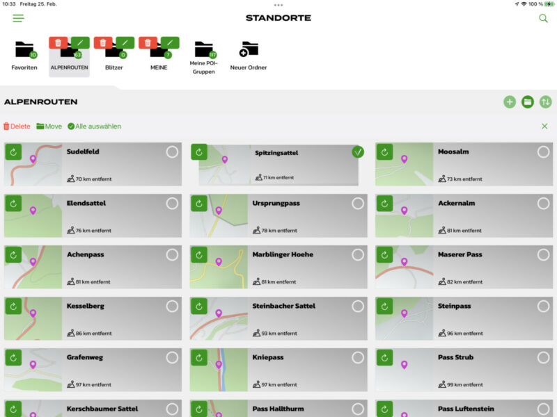

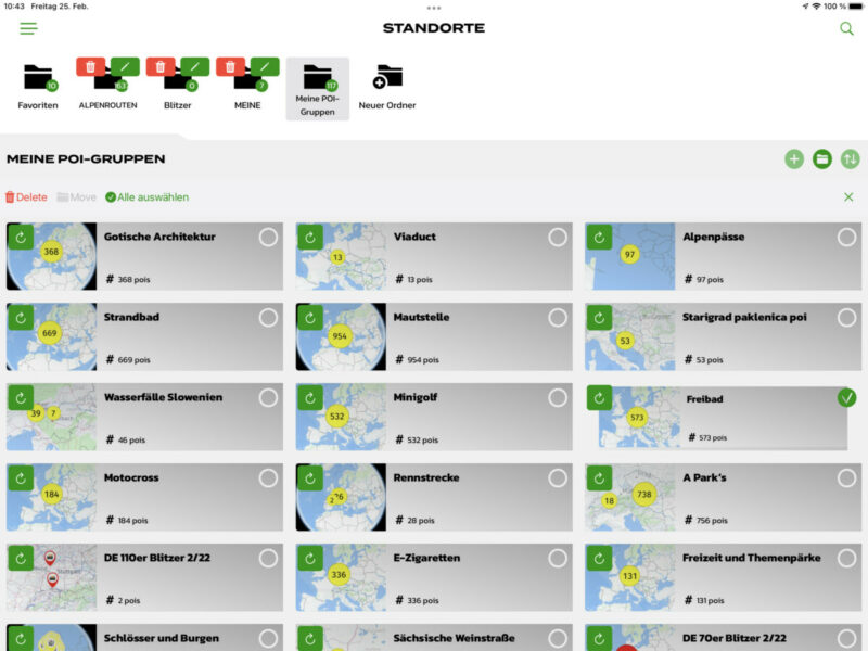

Quote from theigi on 25.02.2022, 03:34Can you access the folder? Also on the folder where the speed cameras are in it? (My poi groups) can also be deleted by tapping on the corresponding poi group in the folder for a longer time without opening the respective poi group, a menu will then appear with delete, move, select all. That helped me when I created a too large poi group. If you keep a poi group smaller (less than 4000 pois each), it works without any problems. At least for me, but also when activating and displaying too many pois in the map, the app slows down or even crashes. For example, an iPhone SE2020 cannot tolerate more than 22000 pois at the same time and the app crashes, an iPad Pro 2017 e.g. "tolerates" up to 32000 pois until the app crashes. So do not activate and display too many pois at the same time, the amount of pois does not matter if it is deactivated.
