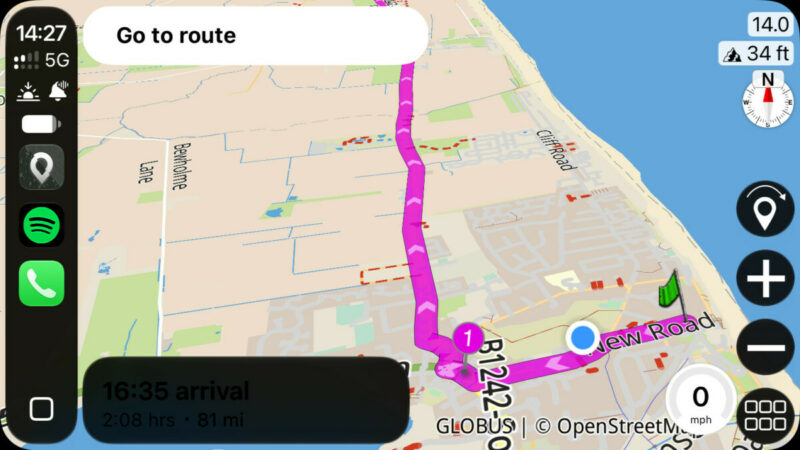

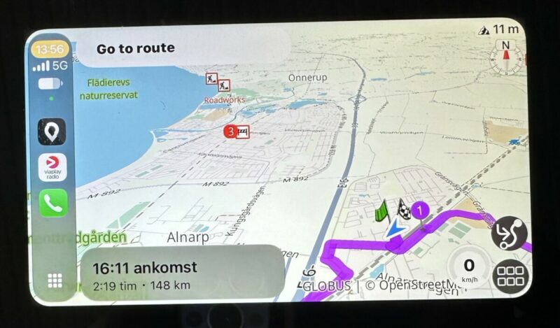

Quote from Marts on 20.09.2026, 18:47On a ride yesterday, I was not seeing the ride trip data (distance to destination, time to, etc.) in the black box bottom left corner of the screen.
See the attached image for more info.
Chigee AIO-5 Lite in Carplay mode
Iphone 14 Pro Max running IOS 27.

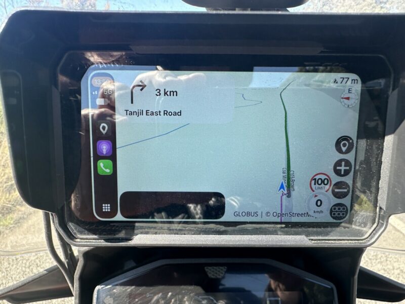

Quote from Dae on 21.09.2026, 00:36My wife and I get it. Restarting doesn’t help.
She’s on a new iPhone 18 Pro Max, I’m on my iPhone 17 Pro Max. We’re both running iOS 27.0 and Scenic 4.45(5). We have identical Chigee units, with identical firmware.
We have similar, but different issues. I see the ETA box in dark grey with black writing, which is very hard to read. Julie sees an even darker box with black writing, which is impossible to read.

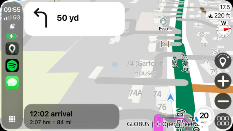

Quote from Dae on 21.09.2026, 02:55We suspect the darkness of the box is related to the Liquid Glass setting. Julie’s is on max, and she has a totally black box. Mine is set lower and the box is a lighter grey, although still too difficult to read when riding
Quote from Dae on 21.09.2026, 12:03I can confirm it is Liquid Glass related. My wife adjusted her setting and the darkness of the box changed.
It’s also not related to the Chigee as it does it on the car’s CarPlay screen too.

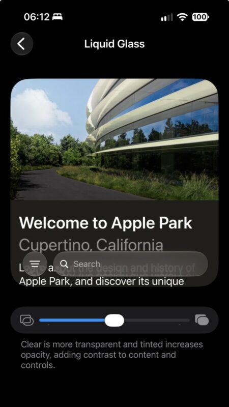

Quote from Dae on 21.09.2026, 23:13Go into the settings app on the phone and search “liquid”. Then adjust the slider

Quote from Boatman on 24.09.2026, 06:53Hi,
I have the same problem. I’m on iPhone 14 pro iOS 27.0 and chigee 5 play, scenic 4.44 Very hard to read.
My wife has not yet updated her phone, she’s on iPhone 14 pro iOS 26.6.2, scenic 4.44 and chigee 5 play. She has no problem.

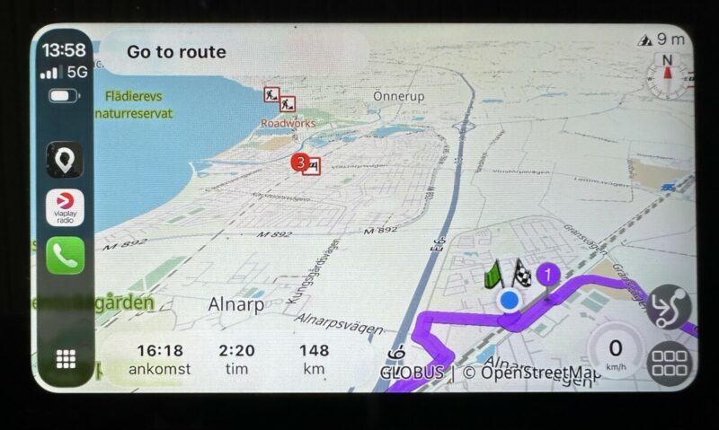

Quote from Guido on 24.09.2026, 12:05Hi Guys... will fix for the upcoming update. Scenic forced the text in the trip estimate panel to black. In iOS27 that panel background changed (and is dependent not he Liquid Glass setting now). In the update I'll release asap, the font color in the panel will now also be chosen by iOS27 (not forced to black by Scenic anymore).

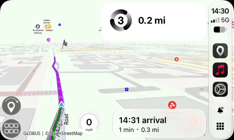

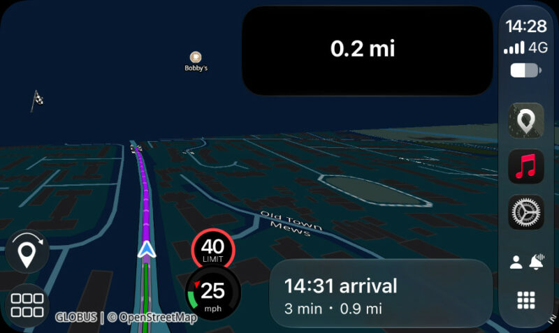

Quote from Sorefeet on 28.09.2026, 09:12Updated to version 4.45
Working fine in light mode but in dark mode still has issues. Text to next turn visible but the turn arrow (or whatever the change of direction is) is almost black so not visible on carplay screen

Quote from Toschu79 on 20.10.2026, 04:57Hi Guido,
Unfortunately, the CarPlay dark mode issue is still present in Scenic 4.46.
The turn arrows are still black and almost invisible against the dark background. Everything works perfectly in light mode.
I have completely uninstalled and reinstalled Scenic, but unfortunately this did not solve the problem.
The issue occurs on both my Carpuride CarPlay display and the built-in Apple CarPlay system in my VW.
Could you please take another look at this issue?
Thanks and best regards!
Quote from Guido on 20.10.2026, 06:32Yes. I’m aware. Sorry about that. Now sure what happened. Have a fix ready in 4.47 which is currently awaiting Apple approval.

Quote from Guido on 21.10.2026, 14:404.47 for iOS, with a fix for this, has just been released and is gradually being rolled out. You can force update through the App Store: https://apps.apple.com/app/id1089668246
