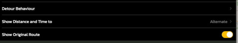

Quote from fxstein on 12.01.2022, 22:23Hi Guido,
I have set this setting to Alternate - which in general is a great thing to have. Unfortunately, the algorithm is broken. It seems to work at first, but once you start riding the times and distances become random numbers. It seems to lose track of what the next stop will be all the way where e.g. the lunch stop (might be stop 3 or 4 for the day) is then always 0 miles and 0 hours away. Have not found a clear pattern other than it happening on every day-ride we do.
Hope this can be fixed.
Thanks!
Oliver
Thanks!
Oliver
