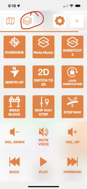

- Save the entry points if the park in a folder
- You can display all locations of that folder on the map too, by using the layers button in navigation mode:
- Then, during navigation (assuming you would want to choose the entry point during a navigation session), double tap the map to go to edit mode.
- In edit mode you can tap on a location marker and add it to the route.
