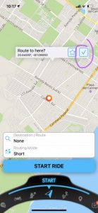

Quote from Guido on 25.04.2021, 10:21Can be a couple of things:
- In the start screen, when you select a location on the map, before you tap 'start ride' you need to tap the 'checkmark' button in the bubble to actually select the location for navigation and calculate the route

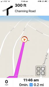

Quote from Lyndon on 25.04.2021, 10:51Guido,
No luck - no change in the response, just the initial voice instruction then the frozen start of the nav. See attached image.
Guido,

Quote from Guido on 25.04.2021, 12:18Just saw your screenshot. I don't think it has anything to do with the Australian phone. It looks like the screen freezes. Could be a performance problem (what iPhone model is it?), but then again I would have received more feedback like this if it was phone model related. More probable is that something is wrong with the hardware of your phone. Perhaps the GPS receiver is fried (have a look at this post if symptoms sound familiar), or the internal memory or even the processor nor working optimal anymore.
