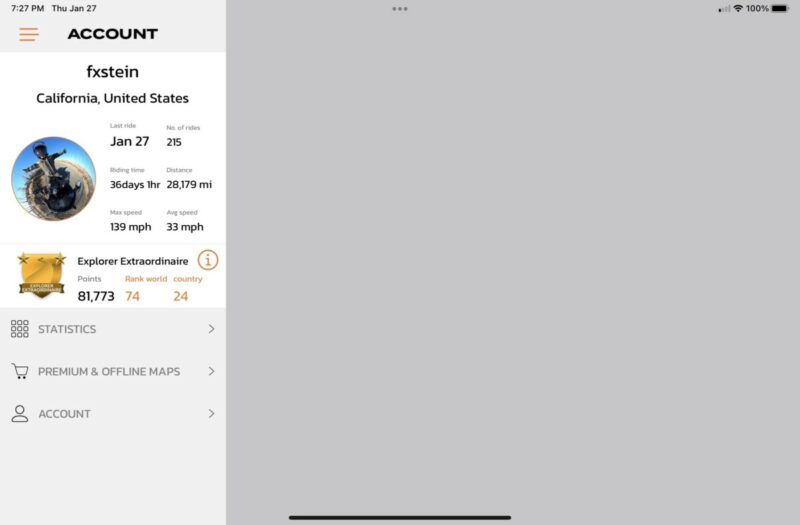

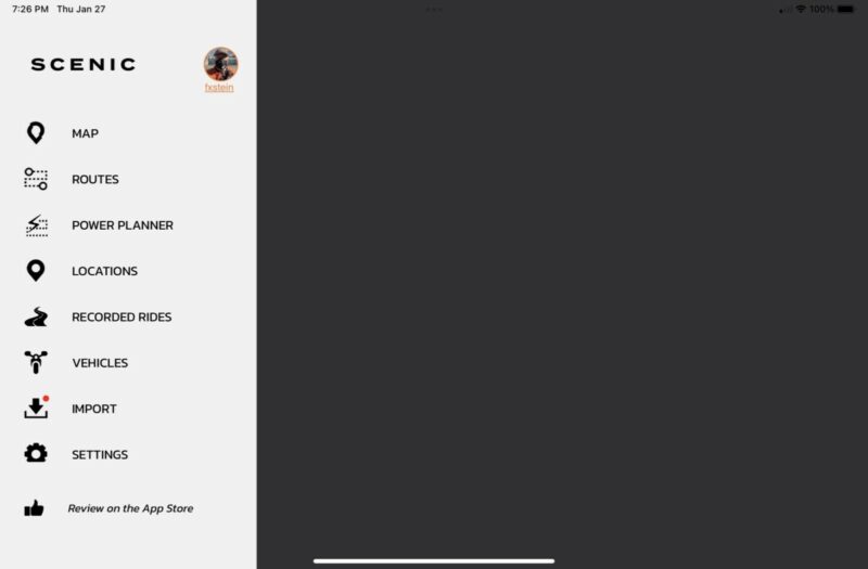

Just set the new iPad mini and after the first login the main profile pic was an old one:
Then when going into he profile and pulling down to update it was the actual one:

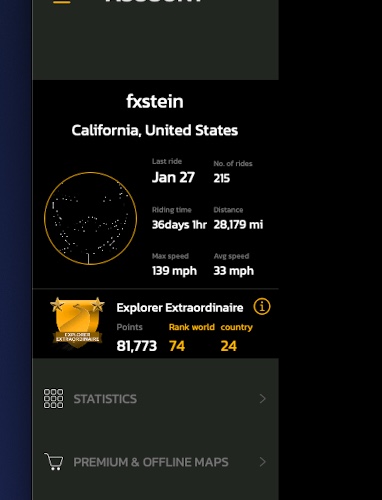

Meanwhile on the MBP the profile picture was missing completely:
