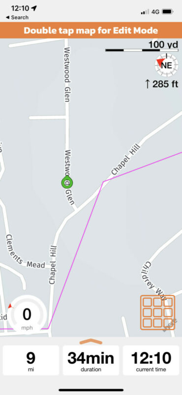

Quote from Jonnyfev on 23.12.2021, 04:18Hi All, loved the old app but really struggling with the new one. When I enter a destinations the route comes with multiple pink lines and black lines . I think the black is trails of previous rides. Can't seem to switch them off. When I am coming to a junction and following say a pink line, there are multiple pink lines going off in multiple directions. I find the app unusable now and previously loved it. I must be doing something wrong but can't find any setting to make it usable. The attached image is just where I am right now
but it look liek this when I am on the road
any suggestion/help much appreciated

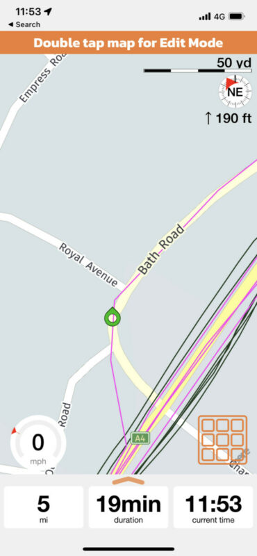

Quote from Jonnyfev on 23.12.2021, 06:13Hi here are examples when actually out and a destination entered
One pic is what a junction looks like and the other is where I am realise to the route
it makes no sense to me at all
Quote from Guido on 23.12.2021, 07:02Looks like you turned one or more 'layers' in the 'show on map' dialog. These layers show routes (pink) and your previous rides (dark green by default) on the map. You can turn this off through the big button menu, and then tapping the layers button.
