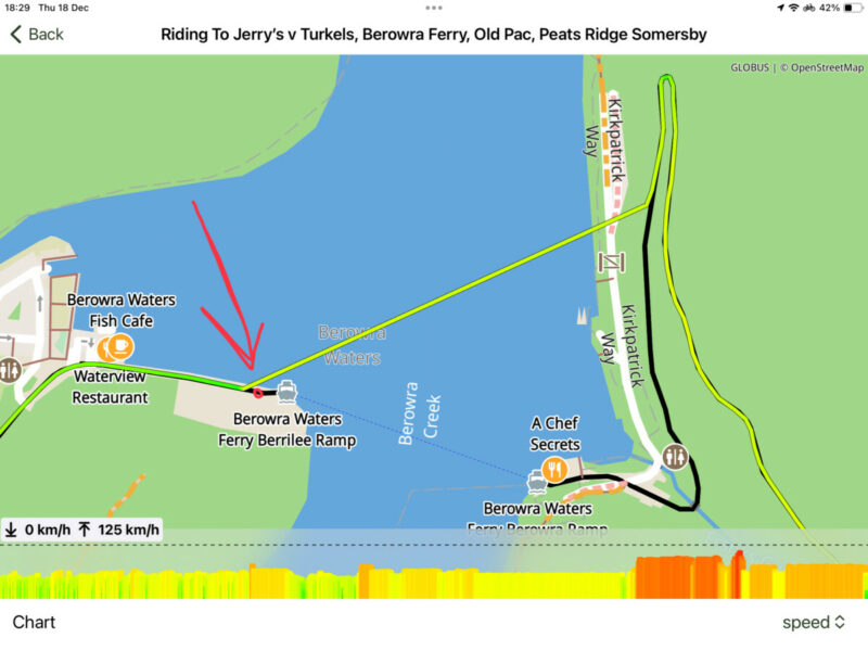

Lost reception for 800m but a Stop was in that zone !
Quote from Old Man Emu on 18.12.2025, 01:31Never seen this before and it had me stumped during my ride today.
I have a stop near a Ferry today and due to a queue I stopped perhaps 30 meters prior to the stop.
Reception seems to have dropped out until I got up the hill across the River. So it seems scenic did not clear the waypoint “stop”.

Quote from Guido on 18.12.2025, 08:08I think I know what happened…
- You stopped 30 meters before the actual stop
- Scenic auto-paused
- Auto-resume engages when you are 100 meters away from the location where it auto-paused
- Consequently, the stop was not reached and the track was not recorded for those 100 meters
- Typically that shouldn’t be a problem because you’d still be on the route after those 100 meters (and the stop will be marked as reached), but maybe because you were on the ferry when you reached the 100 meters this didn’t happen.
What did you do? Did you manually skip the stop? (When you do that all should be good again after that.)

Quote from Old Man Emu on 18.12.2025, 20:25Yes I skipped the stop and all was good. The ferry is deep down in a ravine.
On the way home it happened again whilst still riding when coincidentally right near a "Stop" the GPS jumps 10 meters to the other side of the road then comes back again.
