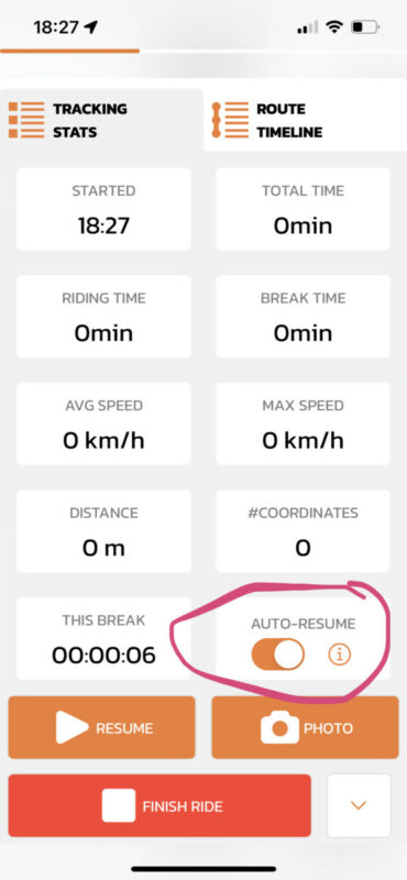

You can turn off auto resume by tapping the ETA bar and going to tracking stats. When the tracking is paused there is an auto-resume switch!
