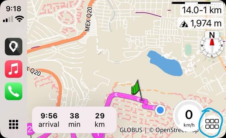

Another issue, in CarPlay, there is no zoom option, and I think it was a extremely necessary function.

To get zoom buttons on CarPlay, you need to select manual zoom. You can do that through the zoom button in the same navigation menu. You can choose between 'turn based', 'speed based' and 'manual' zoom.
