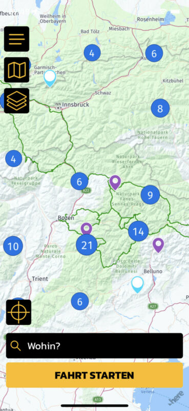

Quote from Mex on 13.05.2023, 23:58Hi.
This may be a workaround for you.
Record your rides to a specific folder. E.g. „Route 66“ After you finished your tour all your rides are in this folder.
Select the third button on top left of scenic map, overlay. It will ask u which folder u like to see on your map. Select „Route 66“ and it shows up like this:

Hi.
