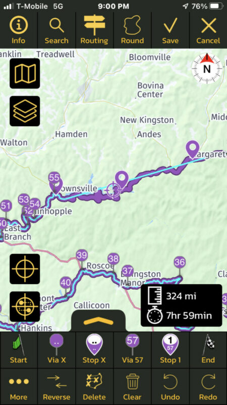

i was in the middle of nowhere and I got this screen.
when this happened it only told me to continue on the road but I had to press on the resume button many times.
my question is why this happen since I downloaded the appropriate maps?
After that when I checked the route I saw a long straight blue line from the point I lost GPS contact to my destination.
is it possible to remove this blue line?

Quote from Guido on 12.08.2022, 21:03If you have bad GPS reception, the accuracy of your position is below a certain threshold, where Scenic says, this is too inaccurate to record and navigate. Consequently also pausing after 90 seconds. Only when the accuracy is good enough again (when the message disappears), tracking and navigation continues.
I think the real question here is why did you have bad GPS reception for such a long stretch? This is very unusual. If you are outside this typically does not happen. Maybe in a mountaines area the signal is lost for a short while around a corner with high mountains on a side, but honestly this is not normal. If you get this more often you might have a hardware problem. It’s not uncommon. Only on this forum there are half a dozen people who had this. Here is one of the threads: https://scenic.app/forum/topic/iphone-11-bad-gps-reception-while-wirelessly-charging/ which links to another thread, etc.
You can’t remove the blue line I’m afraid. This is the line of recorded coordinates. What you could do for next time is disable auto-pause (Settings > Navigation & Tracking) That will at least prevent the pausing and resuming all the time.

Quote from Lbnyc on 13.08.2022, 08:56Hi,
Thank you fir tge info.
i did stay quite a while in the mountain wth quite a lot of curves and forest so that could be the reason.
Note that I didnt have any FM receiption either.
i do not know if it was specific to Scenic as I didnt check the Zumo or the InReach.
