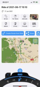

Quote from johnnysneds on 17.06.2021, 17:30Sorry I don’t remember any anomalies with the data/info during the ride. Also the recorded data of the ride after completion looks normal.

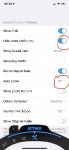

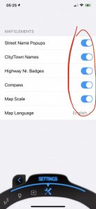

The only items I have changed in the settings menu that I am aware of are - selected hide route behind me, turned auto zoom to off and selected all the map elements to on.
Quote from Guido on 17.06.2021, 18:22OK. Maybe the AutoZoom Off could have something to do with it. Did you change that recently? In other words, did the strange behavior start after you changed that setting? Or did you always have Autozoom to Off?
Quote from johnnysneds on 17.06.2021, 18:27I set it to less a few weeks ago and it was ok. Then a few days ago during a ride it started zooming out all on its own, so I set it to off however it did not stop it zooming out. After that I tried several of the other auto zoom settings to no avail.
seems like I have no option but to do a delete/ re-install?
