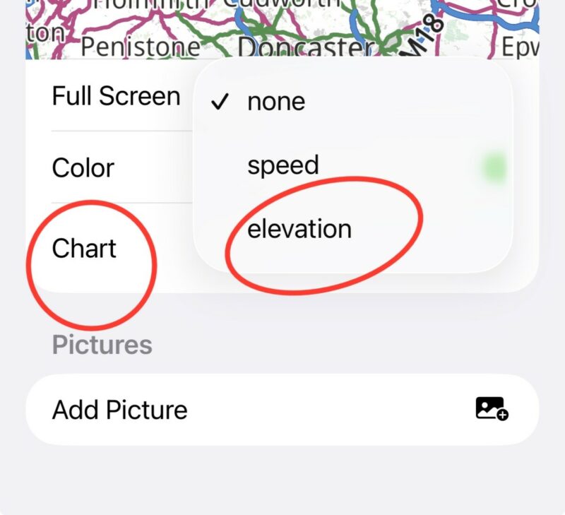

Quote from Dae on 22.03.2026, 00:08Go to “My Recorded Rides” and open up the ride. Scroll down to just below the map overview of the ride and click “charts”. Choose “elevation”
[caption id="attachment_10149" align="alignnone" width="800"]
Quote from BeameronaBeemer on 22.03.2026, 04:17Thanks! I’ve seen that and never changed it but sometimes Elevation data would be exported and sometimes it would’t . I’ll make sure to check it now in the future.
